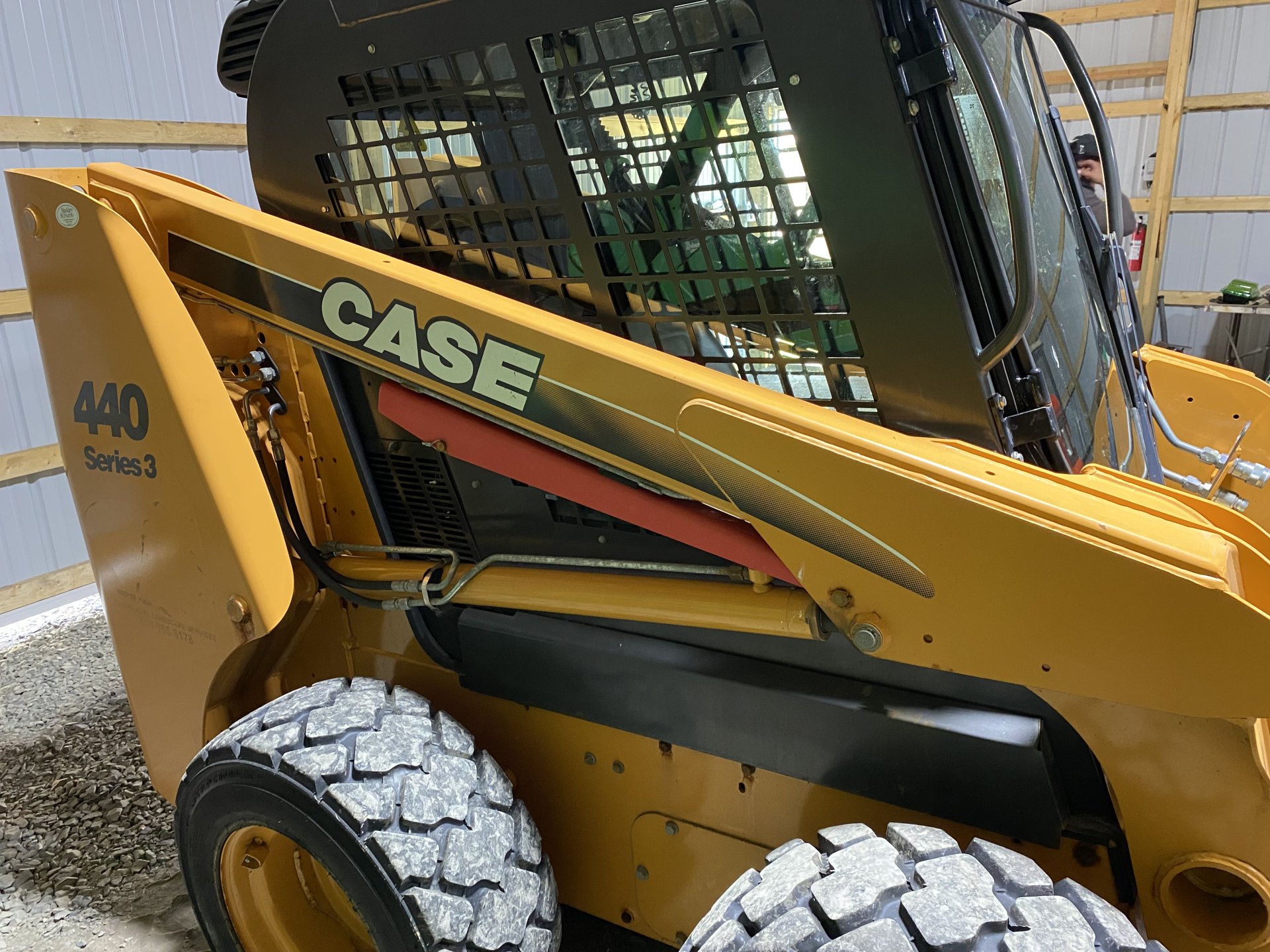

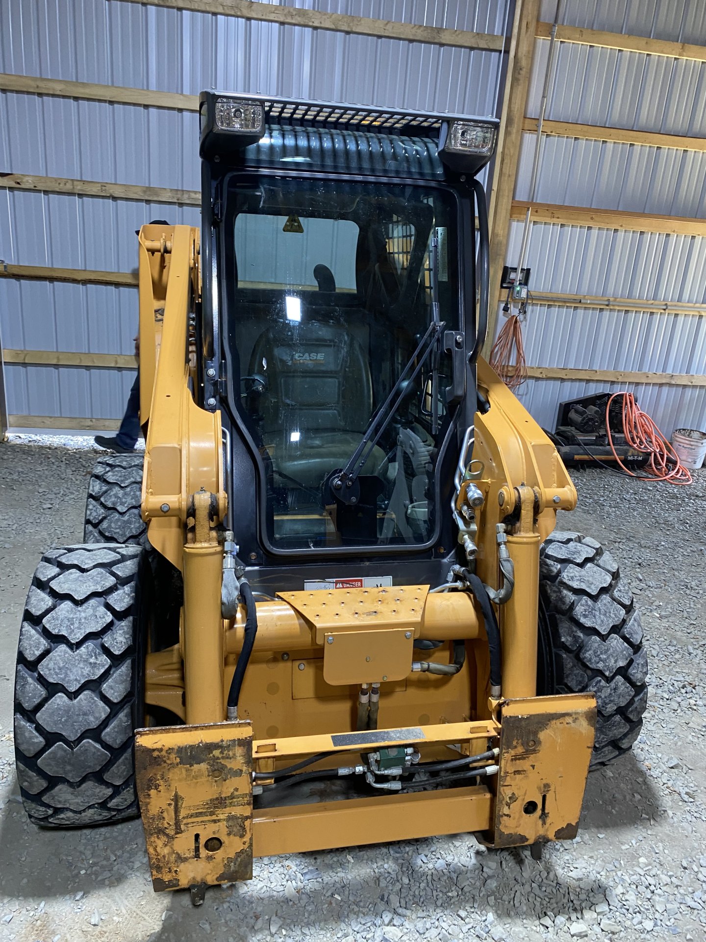

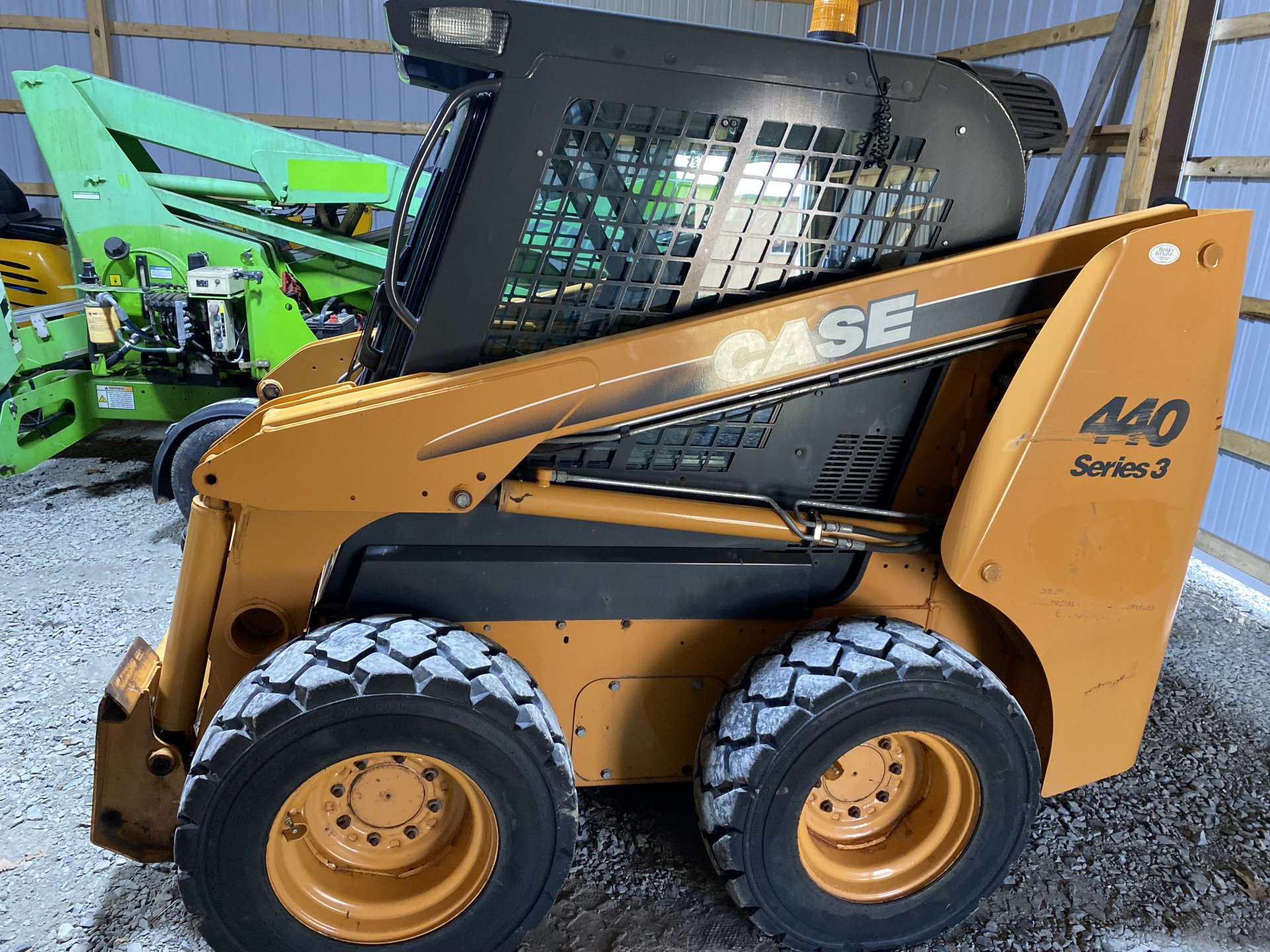

Hello all. I am new to the forum and would appreciate your advice.
I am looking to purchase a 2011 Case 440-3 with only 600 hours. Cab with A/C, 2-speed, and ride control. Price is $33k.
Previously owned by landscaper but being sold by used equipment dealer now. Always stored indoors. That is the original paint and condition is about as good as it gets for this age. Fires up fine and everything looks good.

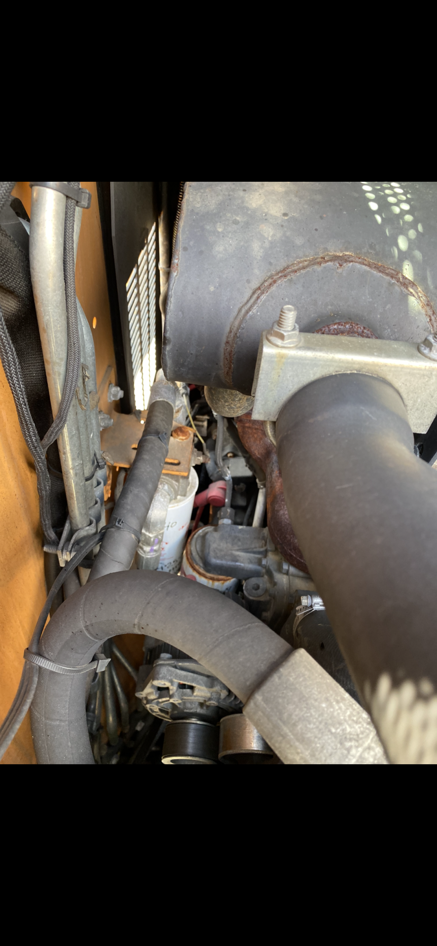

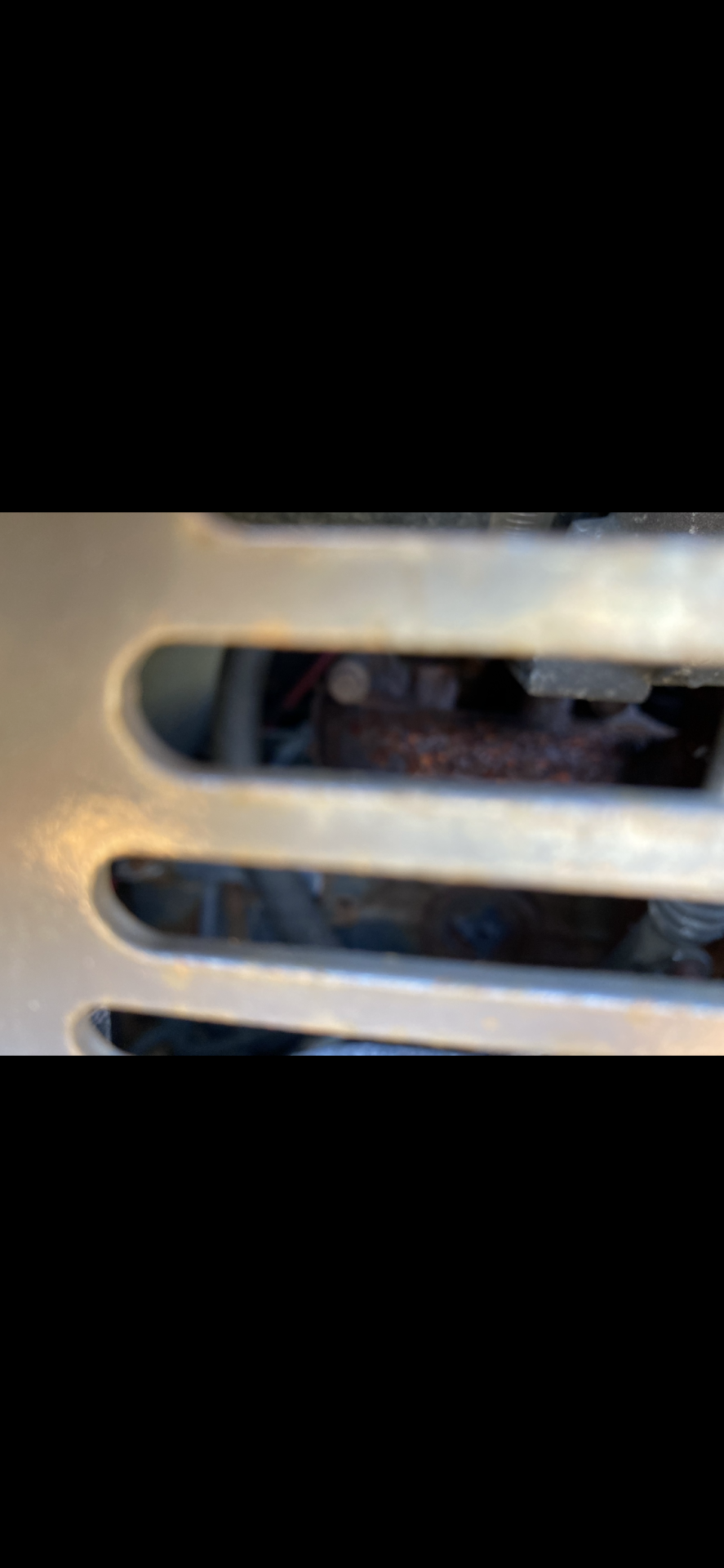

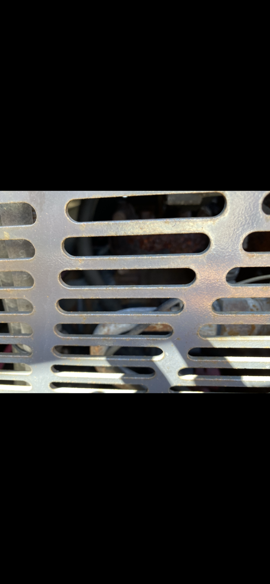

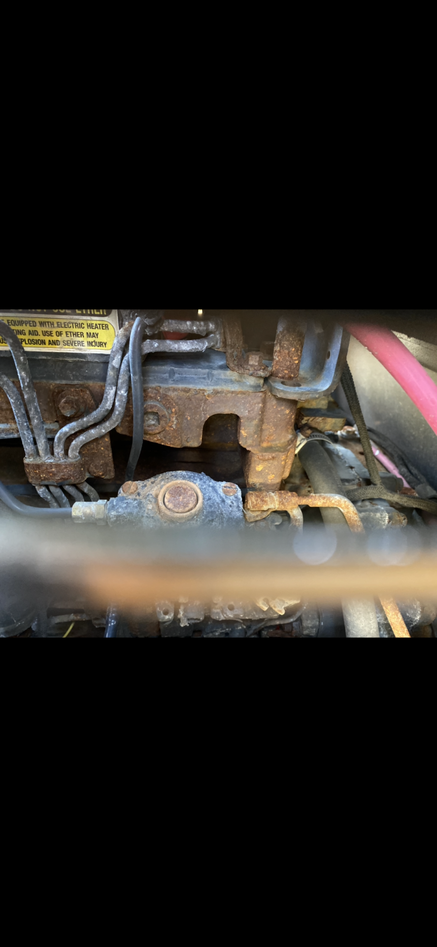

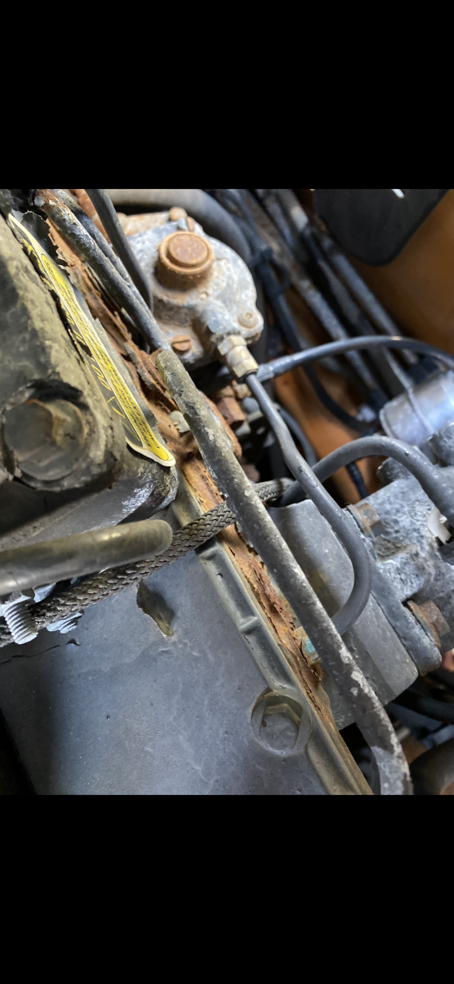

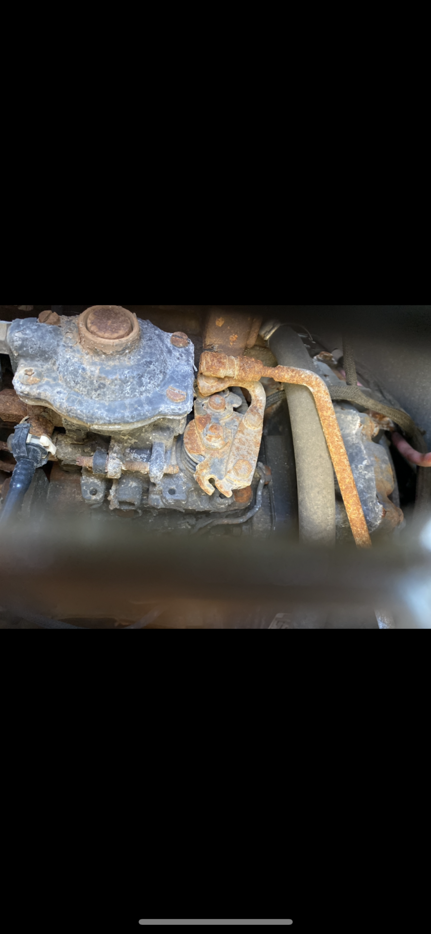

The only thing that bothers me is when I looked through the side grill plates near the bottom of the cab at the back where the boom is.
You can see corrosion on the injector pump, metal hydraulic tubes, and other from when the landscaper pushed snow and some snow/salt got in there. We tried to tip the cab but was so heavy we couldn't get it far enough so I wasn't able to get a closer look.
I have to make a decision now and can't go back to look at it again. Is that corrosion minimal and still worth buying the machine or will I have to deal with a nightmare of replacing the injector pump and a bunch of rusty hoses or worse in the future?
Please look at the pictures. Worth the price? Price is not negotiable. I have included a few pictures of what I could see on the inside. Your help is much appreciated.

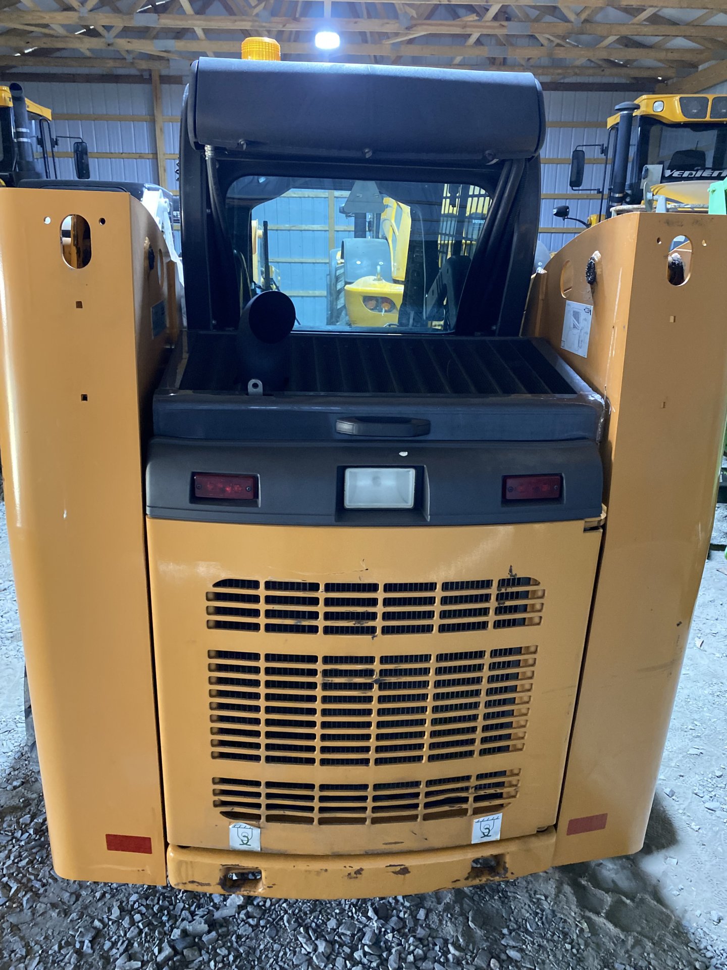

Engine looked fine from the back when doors are opened. It is what I can't see under the cab that worries me. Are hydraulic drives at great risk? Thanks.

just my 2 cents, IMO I gather this machine was towed a lot on salty roadways, thus why all the rust inside engine bay and just was never washed well afterwards
that said, RUST will only keep getting worse, making removing anything rusted harder and worse, cause bolt heads to snap off and or things to strip
SO< how good are you with a torch and or welder to remove and get out broken bolts ??
I own many things much much older in better shape,,
So,
unless you have your heart set on this machine,(and again are good with added steps, welding/torch, and lots of cursing, Haha!, as when bolts break and are rust frozen on to thing your going to need them skills)
I think I would pass and keep looking, better machines are out there for the price your in IMO!
I think the low hours might be making you want it more than condition its in are showing its real worth!

Can't tilt the cab tells me the gas strut(s) to assist the cab tilt are bad. The rust looks abnormal, agree that machine was in the salt wars. That said I might buy something like that if the price was right and soak everything with oil. That being said, I won't own a series 3 Case.

Thank you for the replies. I have taken your advice and told the seller I will pass and keep looking. I always figured that I would be able to tell by looking at the outside of the machine if it was used around salt. I never imagined that the outside could look so good but yet have salt corrosion under the cab. It was a good lesson.

Agree, that much rust on the engine is a definite pass. It's a nightmare in waiting.
