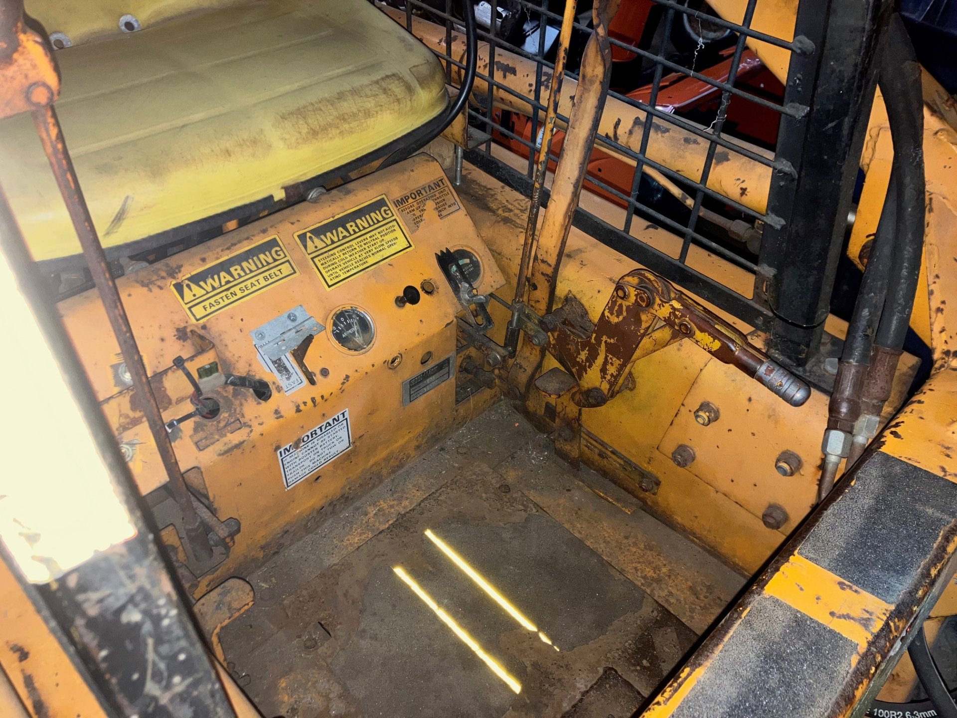

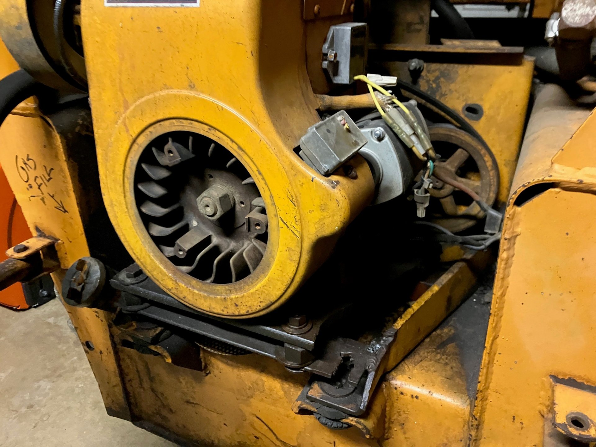

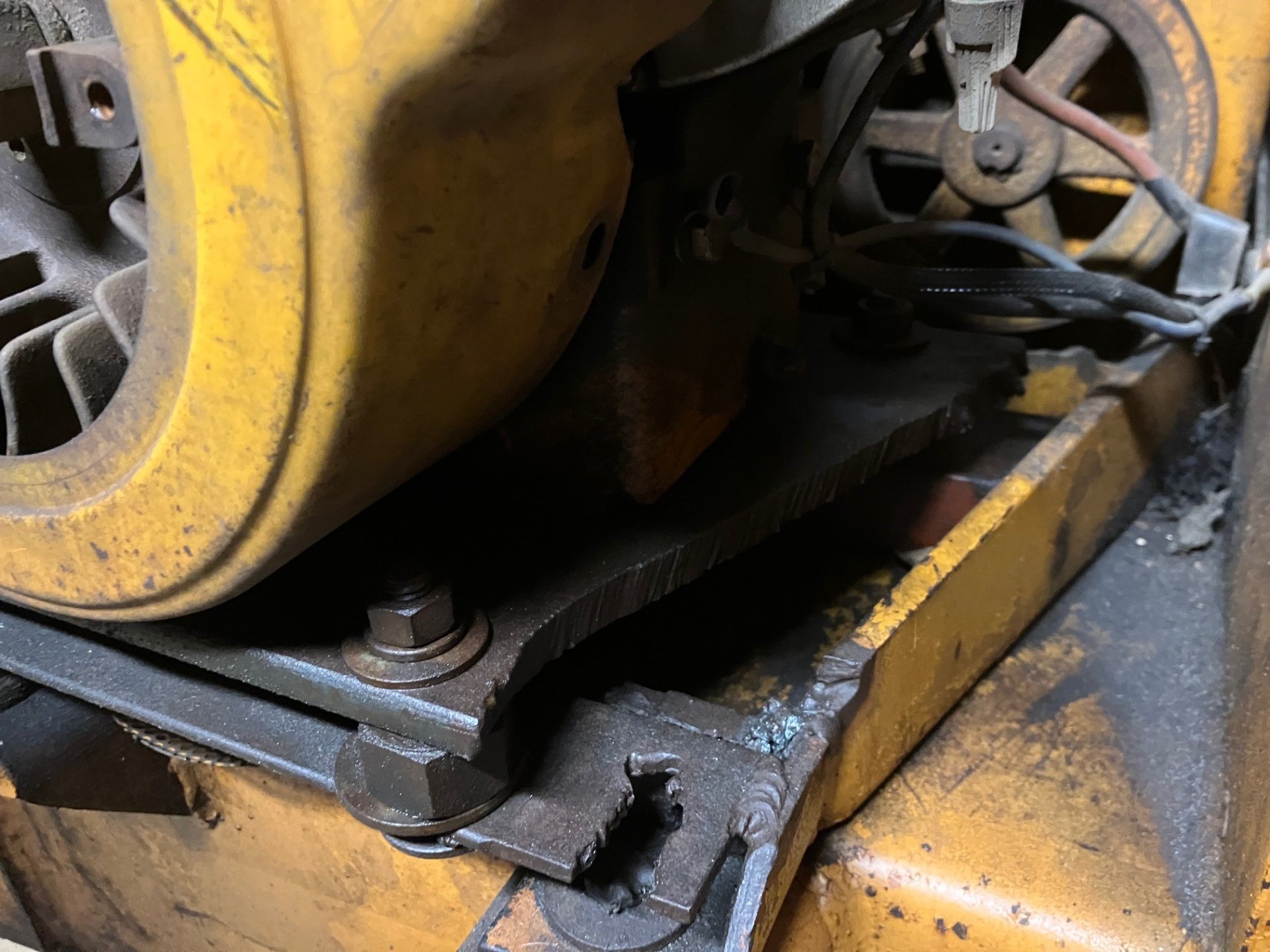

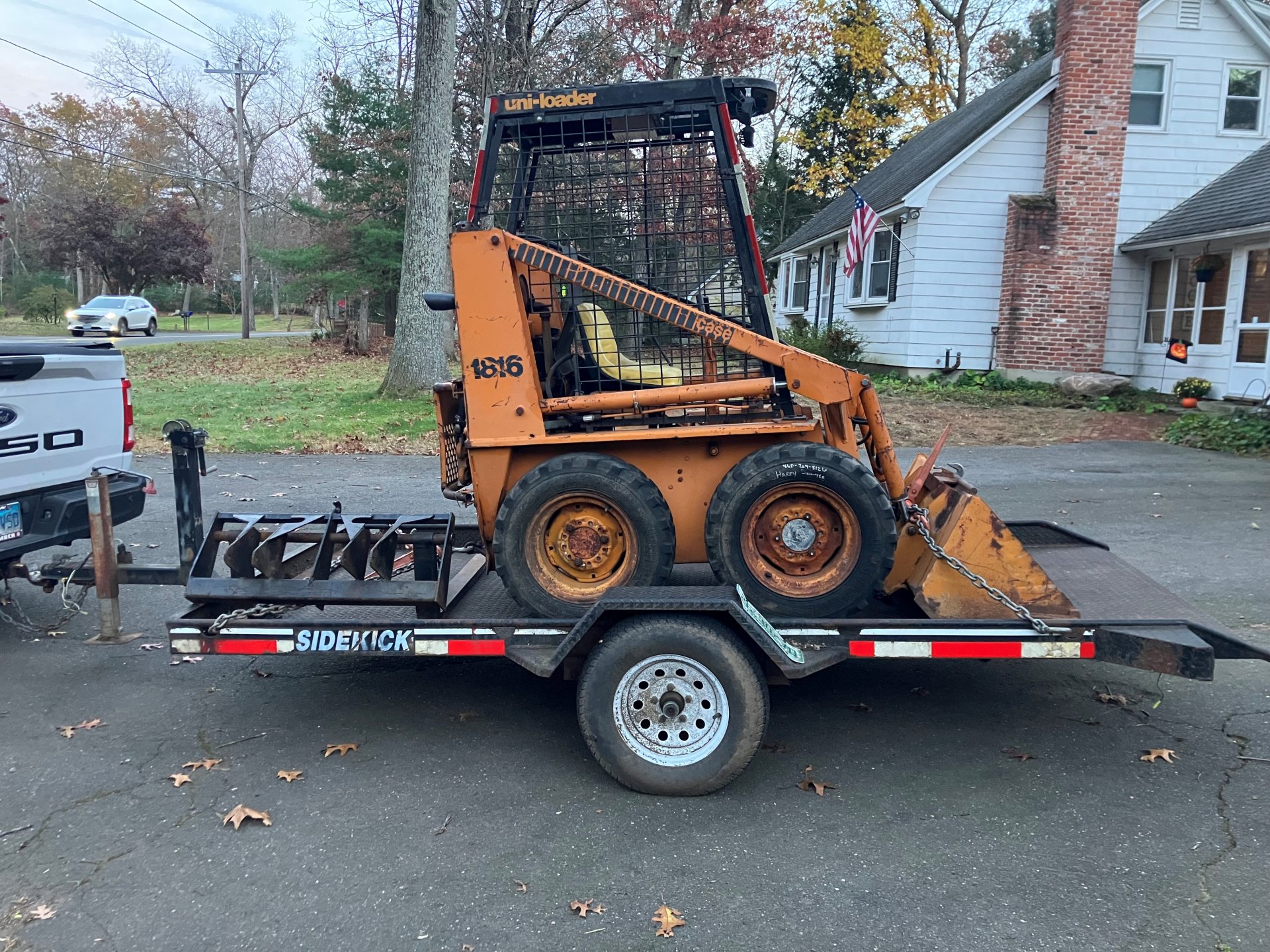

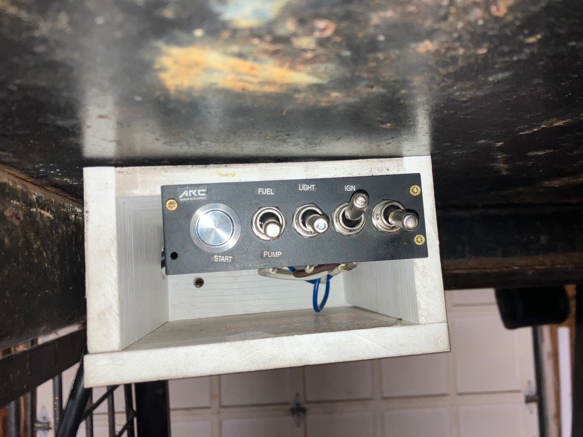

So here it is. It runs well. Engine is a Tecumseh but I do not think its the original engine, the way the engine mount is clearly modified. No way to know how long ago this engine was put in.
The guy I got it from did some rewiring including the box with the switches in it.
As for how well it move around, I have never operated a 1816 before. I have operated other older Case skid steers though.
Its a little jerky but not bad. When I move the sticks forward or backward there is some amount of play before it will move. This could be normal or it might not be. So I will go over all the linkage to make sure everything is tight.

I think that is a 16 hp ohv engine those are pretty tuff , maybe just good maint. on your part and that engine will last longer than you. hahahah the only thing I would do is make a screen to cover the flywheel fan to stop leaves and whatever from getting sucked into the cooling system. I think in the late 60 ies sears roper garden tractors used that engine.

I have never ran a case skid steer but the machines that I have ran ( bobcat ,cat ,wacker-neuson)all take a different touch on the controls, but that one having such a short wheelbase will increase it being jumpy I would think. I would try running it only as fast( RPM wise) as you need, till you get the feel for it.

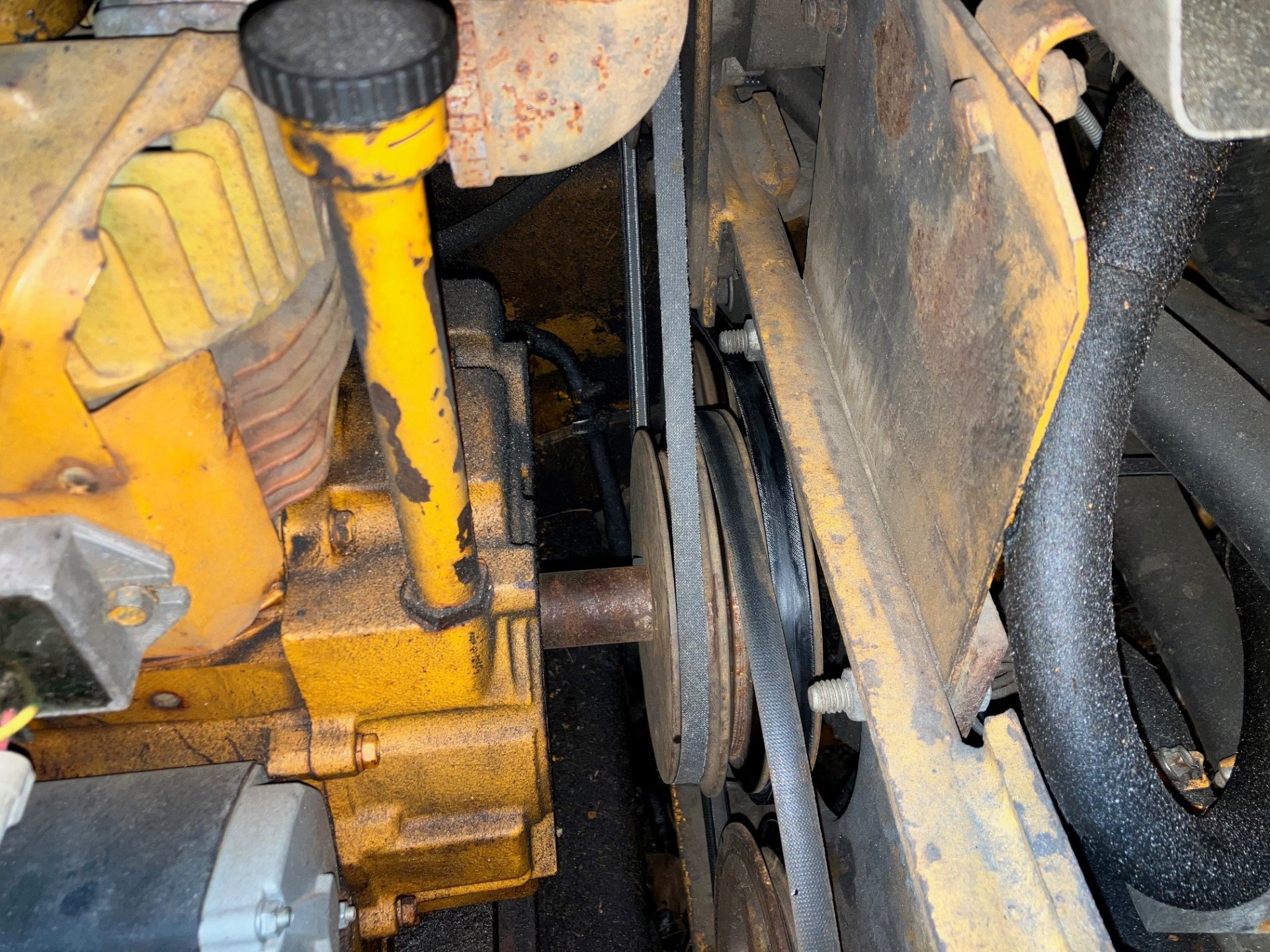

I changed the hydraulic oil filter and most of the fluid. It made a huge difference.
The implement pump belt was loose, I tightened that up and sprayed belt conditioner on the belts. They will have to be changed at some point but are in acceptable condition for now.
