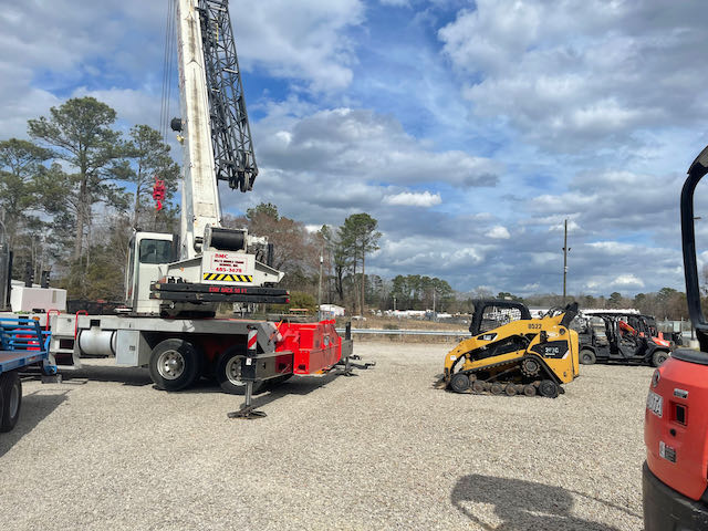

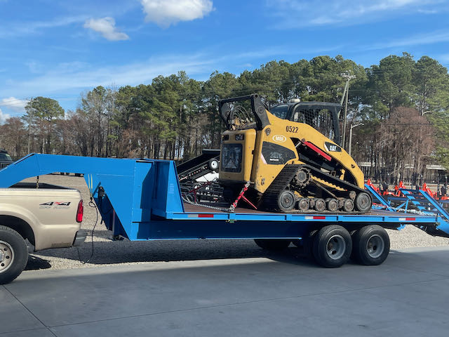

So I just picked up my Caterpillar 287C last Wednesday (2/17/2022) and after considering all options I must confess that I "cheated" - rented a crane and picked up the unit and set it exactly where I wanted on my gooseneck trailer!

i would say that is not cheating that is smart but how you gonna get it off? are you gonna move the crane to off it?
I own the trailer and the plan is to repair it on the trailer and drive it off. Worst case, I'll rent another crane - I pulled it about 350 miles home.
I plan to post a video assessment and some interim reports.
