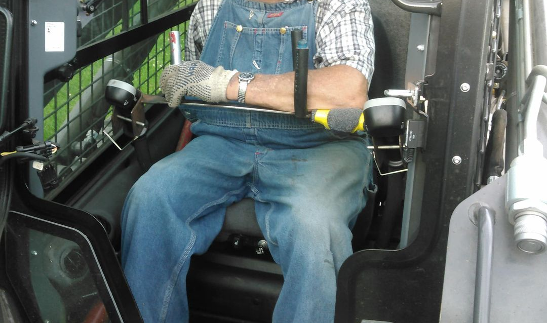

I just saw a post this week from Donald Bergstrom in the Homemade skid steer attachments Facebook group. He made an attachment so his dad who is an amputee could drive their New Holland 232C track loader with hand and foot controls. I grabbed the picture from the post. Hopefully that will give you some ideas. I am sure he would provide more details or pictures if needed.
https://www.facebook.com/groups/444..._k8IF9bC8CPYph1W2vhtbxlYvc-em1so&__tn__=<,P-R
