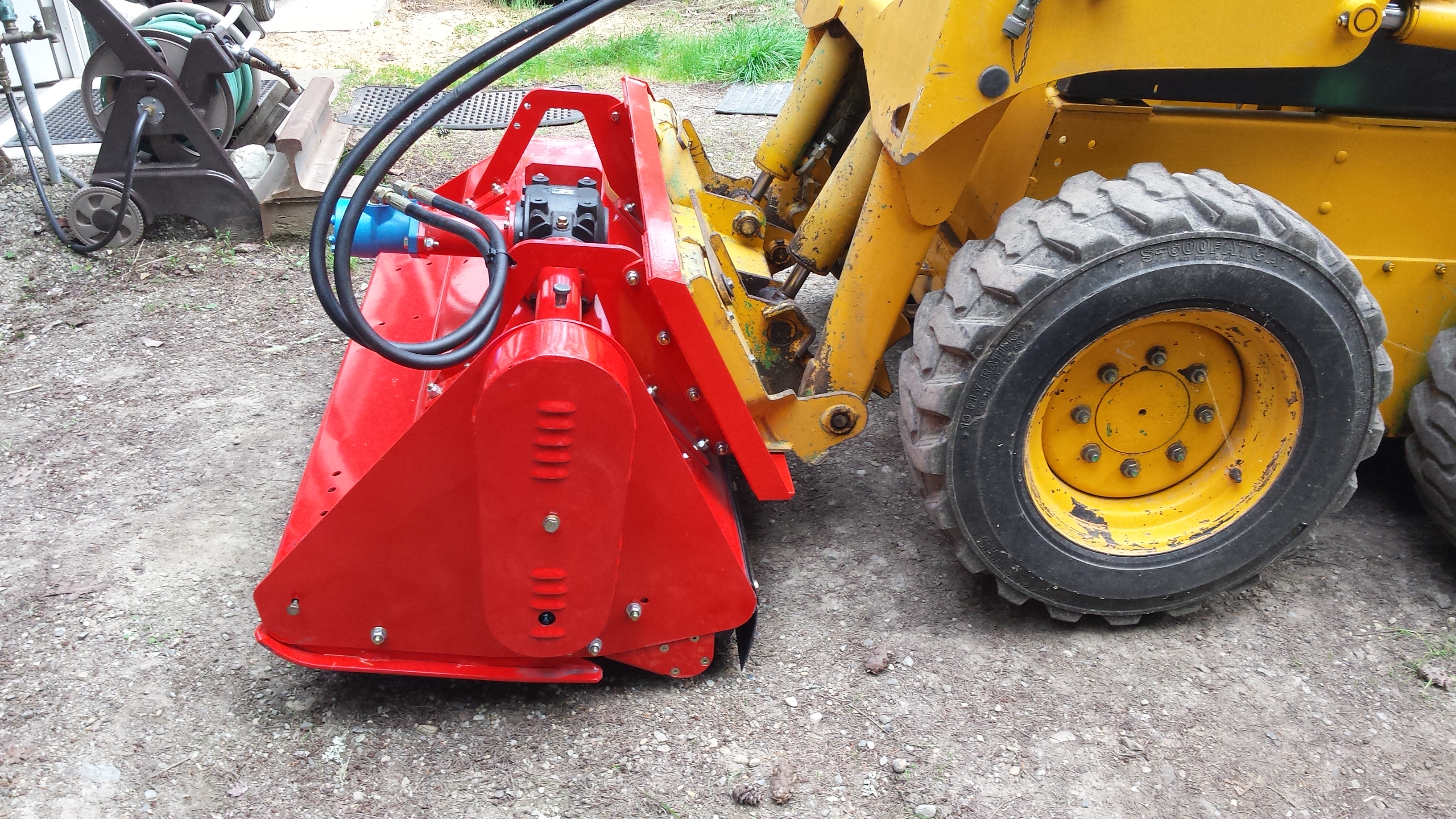

I need to extend the flail mower out about four feet in front of the machine. I believe this can be accomplished with some simple bracketry and longer hoses. Does anyone see a potential problem with this?

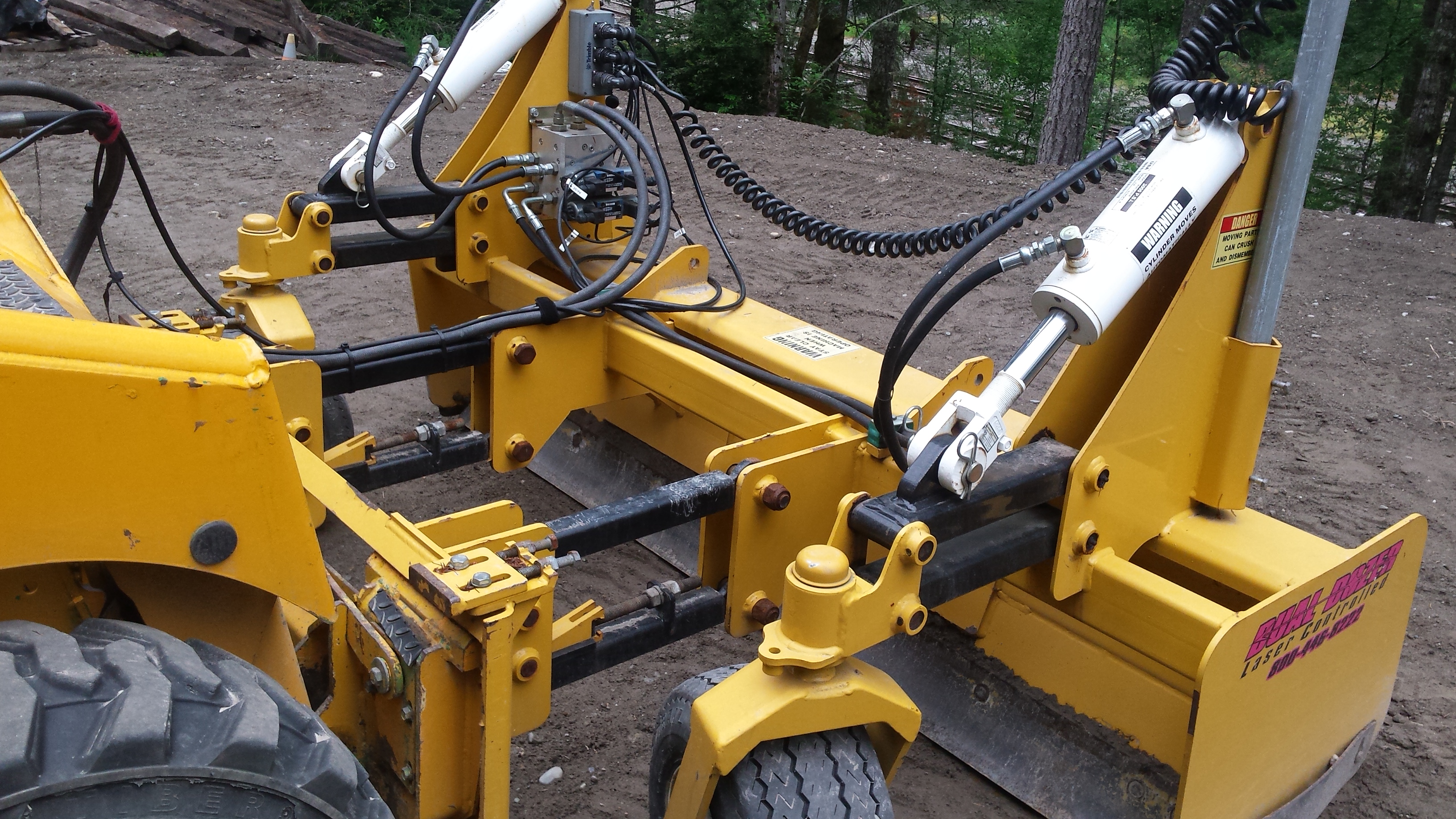

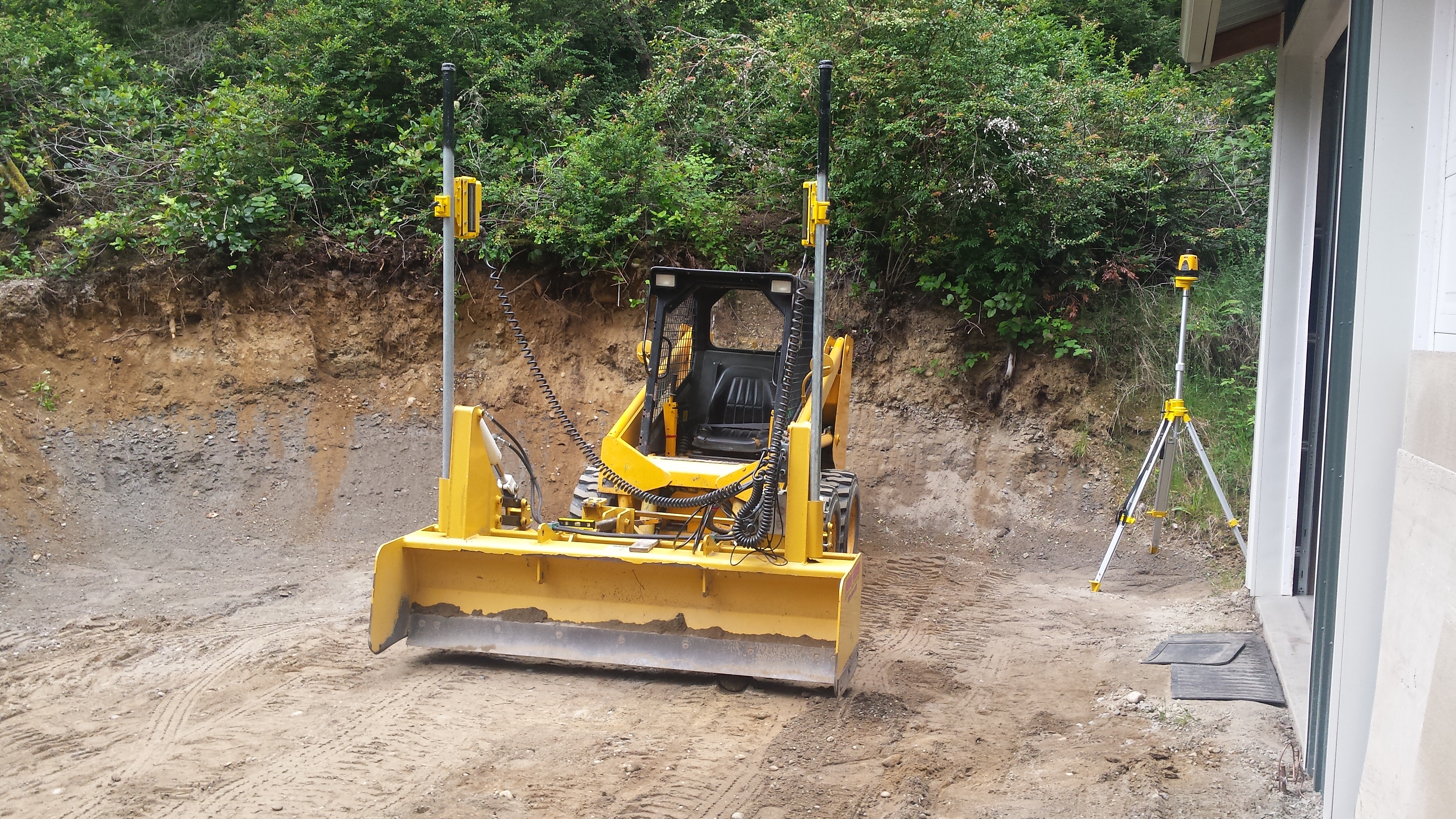

I run a 7 foot Dual Dozer out front and it weighs way more than the mower. The Mustang picks it up off the wheels and maneuvers with no problems. The machine only sees it as additional weight. Yeah, a cab machine would be nice - you buyin'? The reason for the extension is mowing over a berm at right angles.

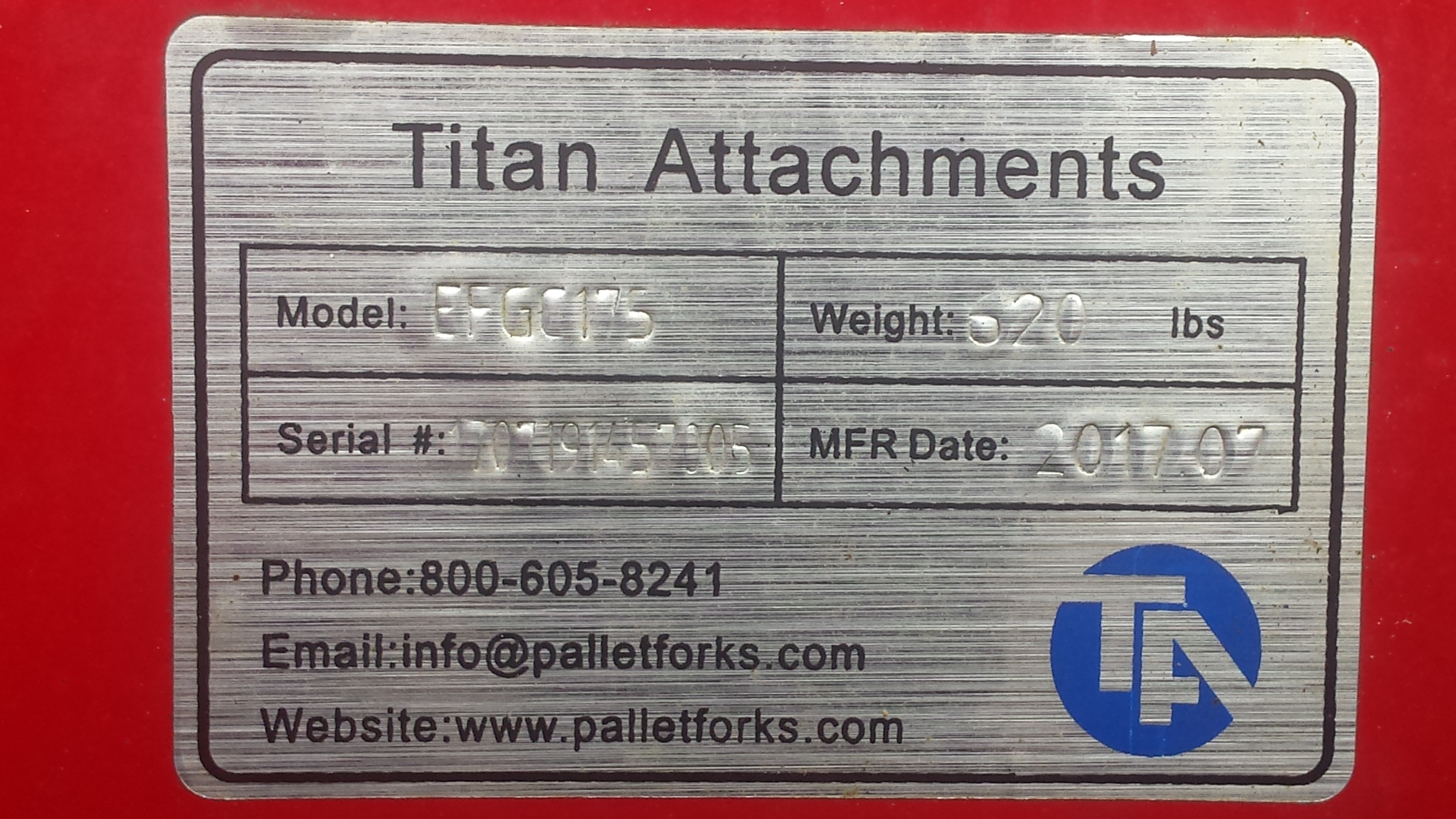

You're starting to scare me, man. Your weight numbers are off by at least a thousand pounds. My flail mower weighs in at ~620 lbs., way under the machine's capacity (I believe a rotary cutter weighs about the same). And FYI, the rotating hammers on my unit don't throw the slash backwards, they counter-rotate and tend to throw forwards, albeit very little, because it mostly goes right back down as mulch. I haven't felt the need to do weight distribution calculations because this mod isn't that critical. I'm a retired engineer, and know Newton and Euclid very well. That said, being an engineer allows me to design and fab some great stuff.
Ddbackhoe, thanks for the link. I think a simple parallelogram and jack screw will do the trick for height adjustments. That way I can just put it in float and greatly reduce any lift/tilt stresses.

do you have hammer blades on the flail? Why are you attacking the brush side to side instead of making longer passes?
With all that dust youre creating, it might be a good idea to check the air filter and radiator at the end of the day.
Yes, hammer blades. Couldn't make longer passes because I was heading into a bank. plus I found a huge hidden stump in there. I did check the air filter and blew out the radiator and oil cooler - not as bad as I had expected.
