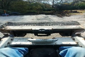

Don't know if you'll be able to make anything out from this clip that I'm wondering about the higher pitched sounds that just makes at certain times.
In other words is something need fixed?
happens more on turns, lower throttle, and I guess what it is is when it's "working harder relative to rpm???"
