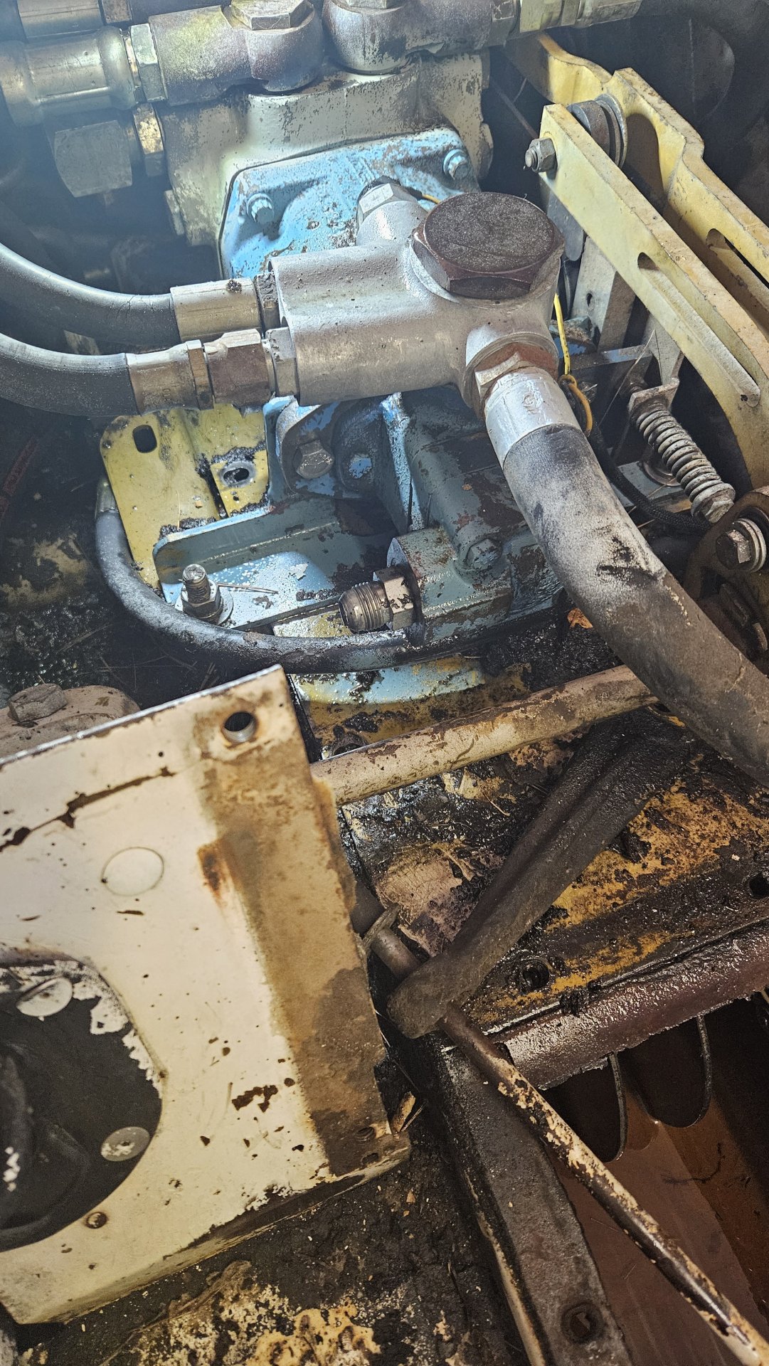

This is the view of mine. My pump hangs over the back plate quite a bit. I hope I can get that plat off.
trobbl
Oct 19, 2021
37
Yikes! I though it was cramped working on my machine. I know these are compact machines, but I wish the design engineers had to spend a little time working on them so they would think about better access for servicing.
ymurf
Mar 6, 2017
40

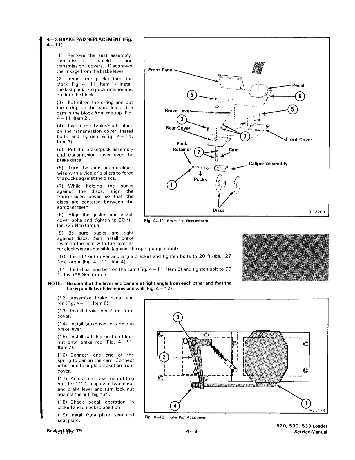

I have to take two bolts out and hope my pump will raise up enough to let that plate come out. Does anything come out mounted to the plate or just the plate? I see another bolt in the plate that I assume is holding something for the brake?
trobbl
Oct 19, 2021
37
You are correct. The brake block is bolted to the underside of that plate. See the item labeled caliper assembly below. I don't remember if there was enough clearance to get the plate off with the caliper attached. You may need to unbolt the caliper from the plate first.
